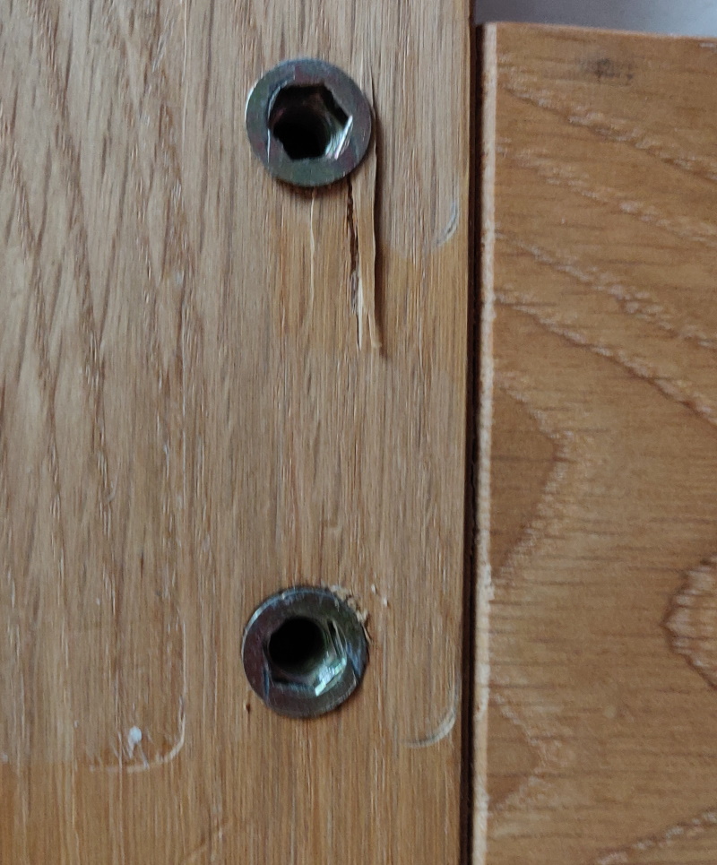

« on: October 26, 2019, 05:52:02 pm »
I hate them. These things:
It's a bit obvious really - you're screwing metal into so-so wood, and a little movement over the years they work loose.
I'm no skilled woodworker (but if I was, I'd never use these on something I made), but I need to fix them tight.
My thinking was along the lines of:
1. Fit oversize inserts (real pain to source, and they'll just work loose again, in their own time)
2. Glue inserts back with wood glue (but it's metal into wood, so that isn't going to do a good job)
3. Glue inserts back in with Alradite (but Alradite will only survive if it's rock solid - any movement, and the Alraldite will crack)
I'm tending toward 3 as being the most likely to hold for a few years.

Is it just the inset that's damaged or the hole in the timber or both?
What size are the threads?
It's a combi, and I've seen it before on previous beds - the insert has some of its crude thread damaged, and the hole is also damaged.
They drop out fairly easily, but there's enough insert thread to get some grip, but not enough wood left to grip.

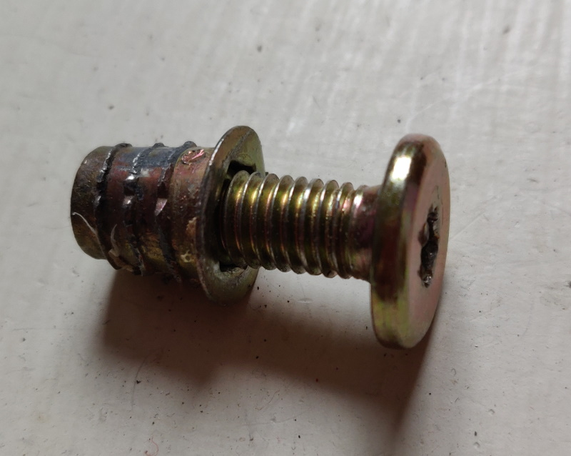

« Reply #6 on: October 26, 2019, 08:49:06 pm »
That's v kind, Rae! I'm OK to get some locally, but I didn't actually know what they're called. :-[ :-[ :-[
If somewhere like Screwfix sells them, I'm happy to grab them, and save you the grief, if you give me a hint at the name.
Here's the screw and insert thing. I reckon the inner part of the screw is 6mm, as you suggest:
The insert is pretty short - 13mm? (which can't help it's ability to grip).
Oh, and Gorilla Glue it is, thanks both!

« Reply #9 on: October 27, 2019, 01:28:13 am »
That appears to be 8mm and not 6mm. The measurement of a thread is taken over the outside of the thread.
