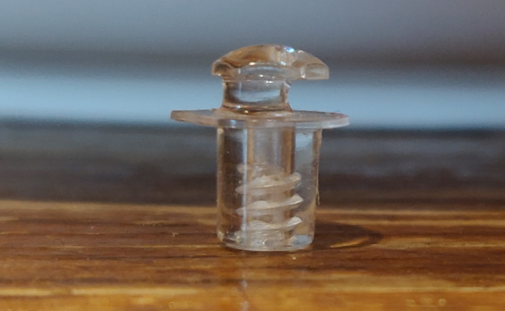

« Reply #21 on: October 02, 2019, 06:46:21 pm »
The pins are eccentric.........
Waking this one up now we're back to a damp season again.
I fetched my pinlock out. It happens to come on a visor already (that was the cheapest way of buying one!), so I dipped both in water, and it leaked along the top edge.
That isn't going to do the job, is it.
I unscrewed the pins, and I can now see the eccentric on the pin - they are absolutely tiny.
Actually, my phone can see the eccentrics (I may be able to, if I pretend). This is about the height of four stacked ants. Seriously:
Do I go as tight as possible using the eccentrics? (assuming the pinlock doesn't pop off the surface)
All v fiddly, I must say.
  • Posts: 4232
  • Karma: +39/-3
Re: Best anti-fog solution?
« Reply #22 on: October 02, 2019, 06:56:54 pm »
All you can do Rich is make sure the pinlock is fitted correctly and just snug them up. If you tighten them too much it will distort the part that the cam sits against.
  • Posts: 2212
  • Karma: +27/-1
« Reply #23 on: October 02, 2019, 07:14:29 pm »
So, you're saying fit the pinlock, and then swing the eccentrics round to gently tighten?
I've only ever seen videos of people flexing the pinlock in, which did seem a bit hit & miss me too (and proved to be so the last time I had one)
  • Posts: 4232
  • Karma: +39/-3
« Reply #24 on: October 02, 2019, 07:30:16 pm »
You need several hands, make sure everything is clean and dry flex the visor flattish and insert the pinlock making sure it sits properly and snug up the eccentric pins, simples  ;)

I've never had a problem with the pinlock visor on either my BMW helmet or my Schuberth; but then again, I'm one of those weirdos who actually read the fitting instructions and follow them  8)
Once the pinlock visor is in place you should never be able to 'slide it' into a tighter or looser fit with the pins without lifting the centre of the pinlock off the main visor because the pinlock has a silicone seal around the edge and that should never move without lifting the pinlock visor.
