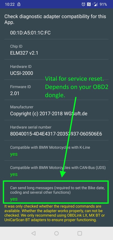

Dongle Check Screen
Before you purchase, the Motoscan app can check what capabilities your ODB dongle has.
Dongle check screen:
Menu Structure

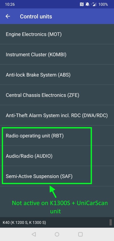

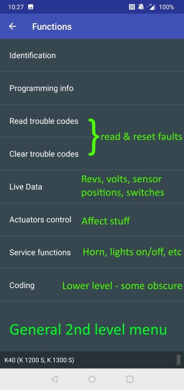

The main part of the app is a tree of menus:
- top level: big sub-systems like Engine Electonics, Instrument Cluster, etc.
- 2nd level: read live data, read settings, play with 'actuators', send control codes (whatever they might be)
- 3rd level = individual settings/actions
Top-level menu:
2nd-level menu (slightly different depending on which top level menu you picked):

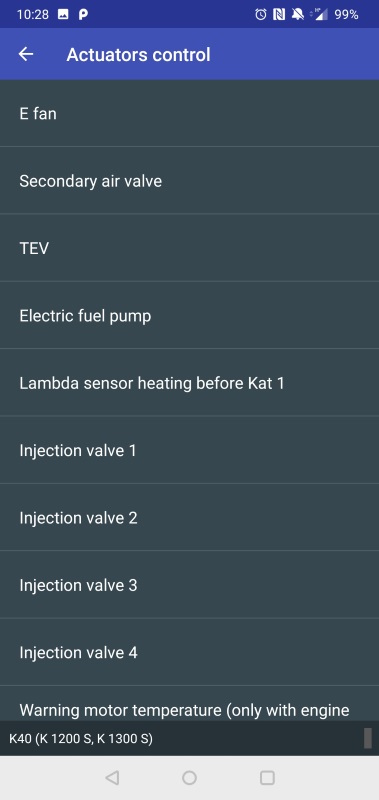

3rd-level example - this one is some of the Engine Electonics'actuators':
I only played with one in there - turn the fan on and off. The rest I left alone.  :P

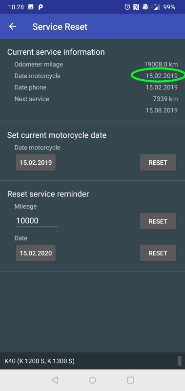

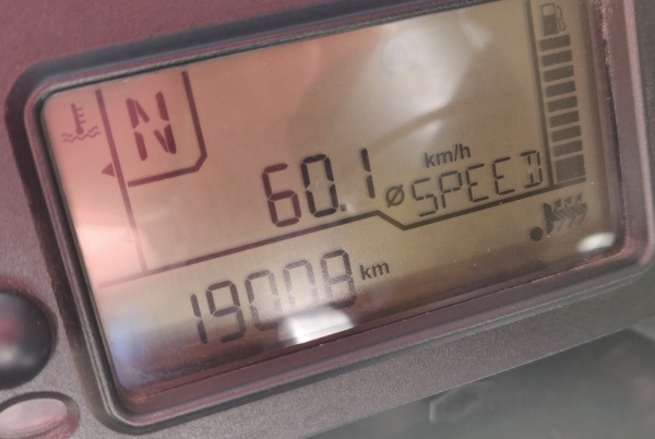

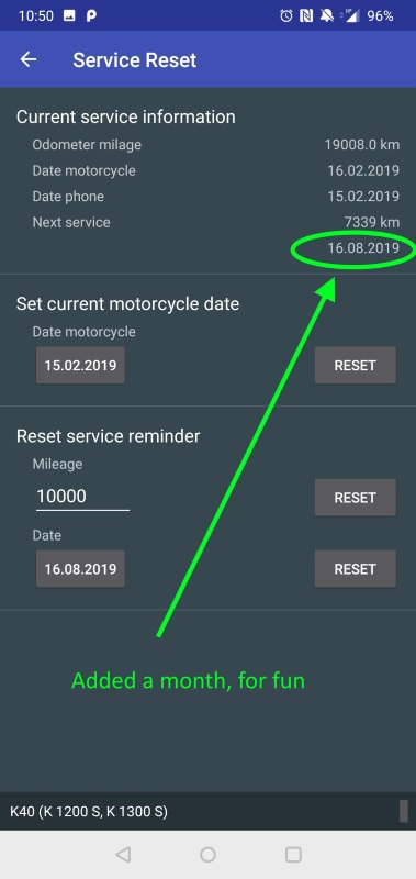

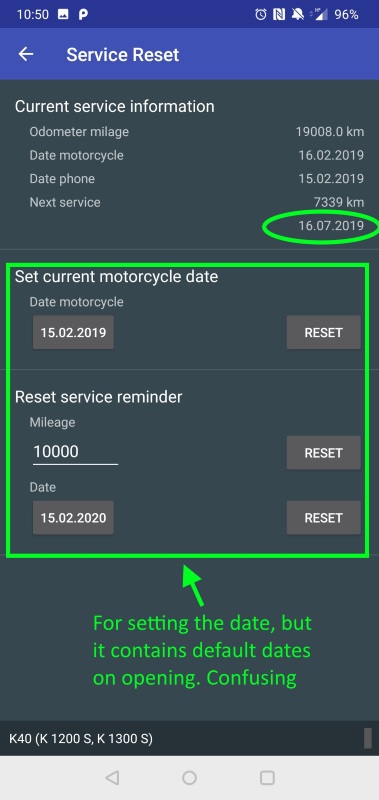

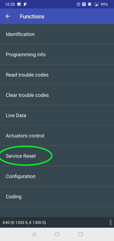

Service Reset
Instrument Cluster-> 2nd-level menu , showing 'Service reset'

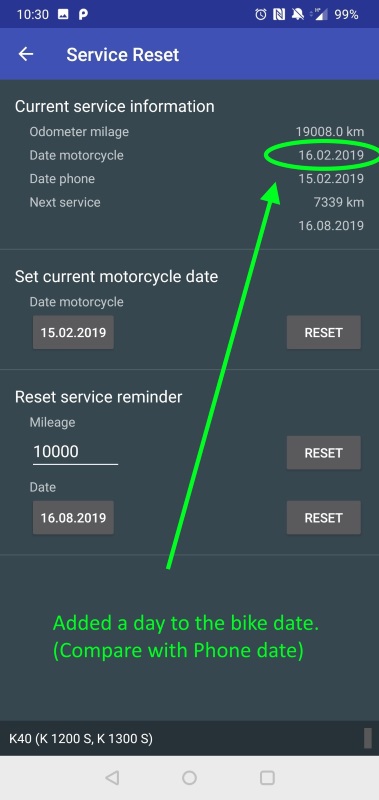

So, off we go into the service reset menu (3rd level of menu, i.e. the bottom), and change the service date:
Service reset screen - old service date
Service reset screen - new service date
And you can also change the motorcycle date:
Service reset screen - old motorcycle date
Service reset screen - new motorcycle date

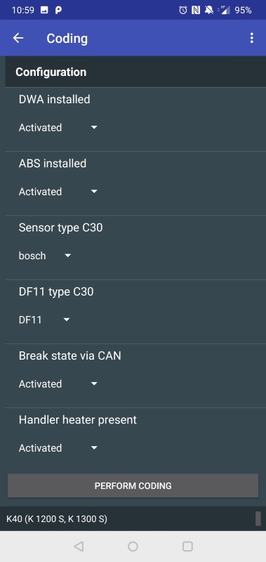

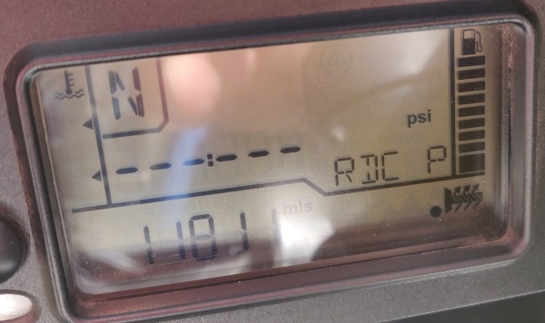

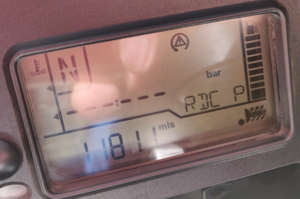

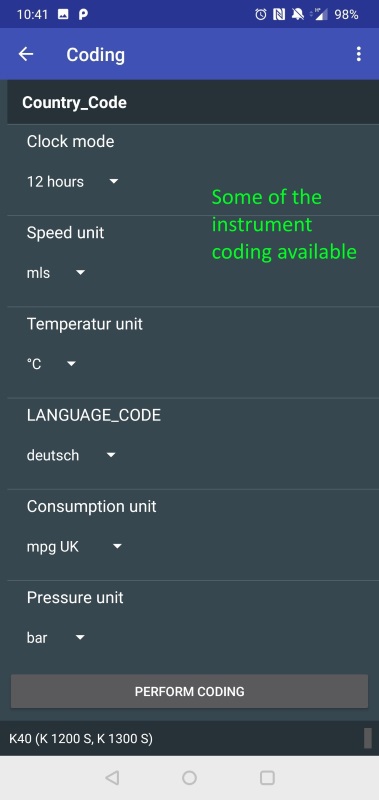

Tyre pressure units

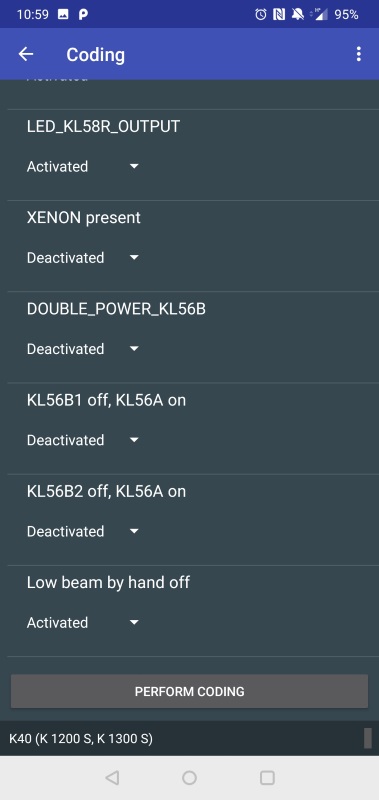

Instrument Cluster -> 3rd level menu -> Coding: including the 'Pressure unit' setting
Before - Bar
After - PSI
I also did MPH -> kilometres for fun:
KMH

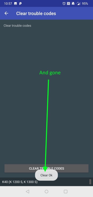

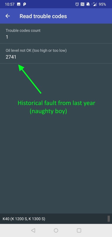

Fault clearing
This is a historical fault from last autumn that was still hanging around. I cleared it.
Read faults (Engine)
Fault cleared

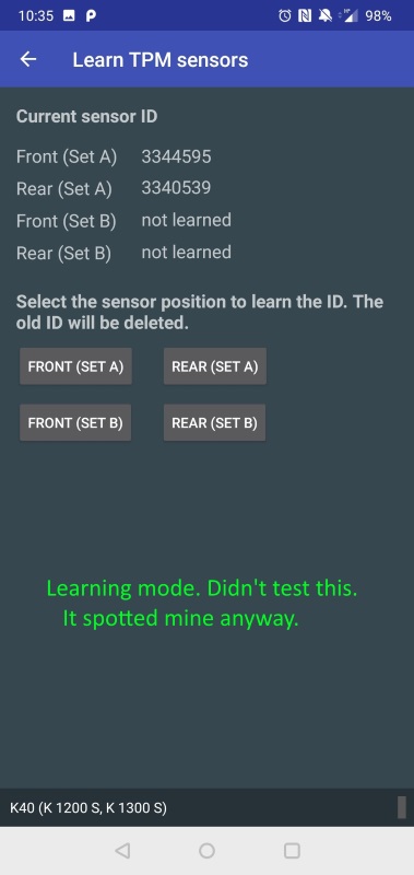

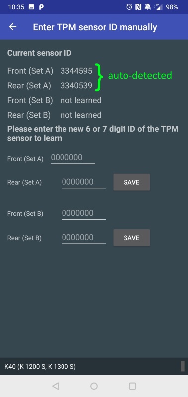

TPMS
TPMS can be done by 'learning', or by manually entering the details. You can delete them too.
However, I didn't test the 'learn' or 'manual' features, other than make sure it found mine.
TPMS 'learn' mode
TPMS manual entry
Things that didn't work
There are a vast number of settings, so I just hit stuff I recognised, that looked safe to run. Here are few things below that didn't work.
It's not clear whether it's hardware (dongle), software (Motoscan), or if that setting just isn't available on a K1300S.
This is where a comparison with GS911 would be useful.

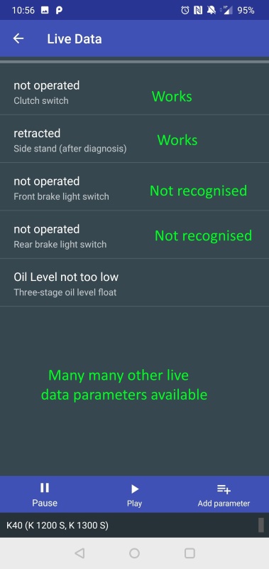

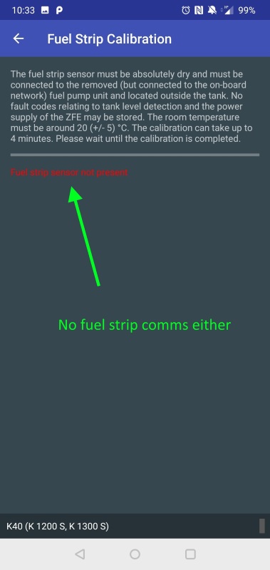

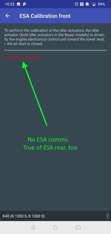

Bits that didn't seem to work:
- ESA detection
- fuel strip detection
- brake switch detection (clutch and side stand worked nicely, though)
- the app didn't like having the bike switched off and on again. That crashed it. At least, I think that was the crash reason. It restarts in about 10 seconds.
Live data example - brake switches not recognised
There is a huge choice of parameters you can add to this live screen above. I picked boring stuff, but you can do revs, volts, throttle position(I think I saw that, but didn't get the screen) and so on.
ESA not recognised
Fuel strip not recognised

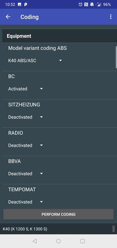

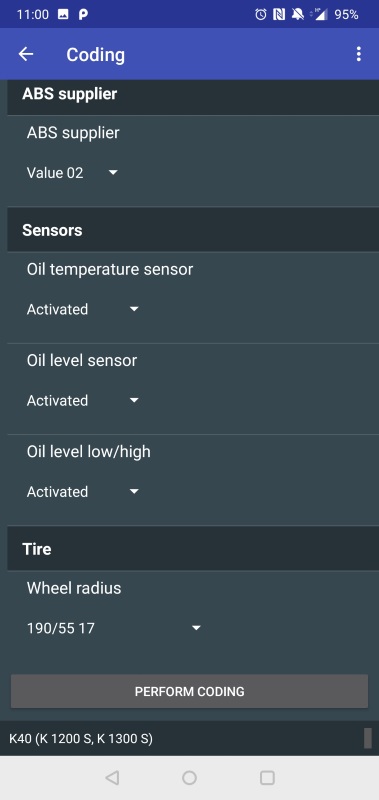

Just for fun, a few of the screens full of stuff I'm not sure are useful/usable.

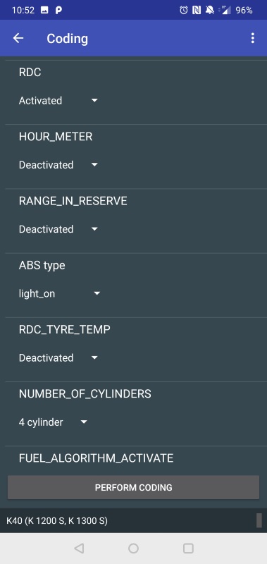

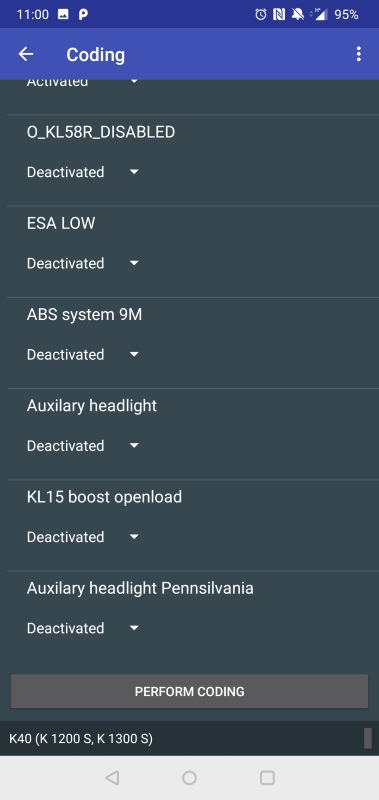

These are from the Engine -> Coding menu, and Instrument-> Coding menu.
Coding screenshot
Coding screenshot
Coding screenshot
Coding screenshot
Coding screenshot
Coding screenshot

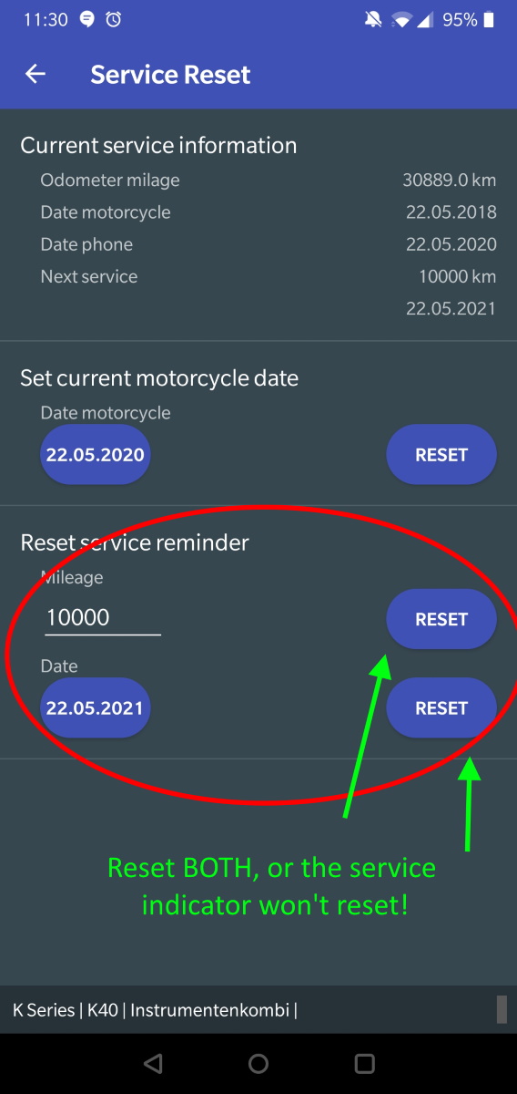

« Reply #44 on: May 22, 2020, 12:00:14 pm »
Reminder (possibly just to myself  ;D):
- to reset the service indicator using the MotoScan app, you need to change BOTH the mileage and date, since the BMW logic is:
- by 10000Kms OR 12 months time
When successfully reset, the result is reflected in the grey text at the top.
« Last Edit: May 22, 2020, 12:03:06 pm by richtea »
