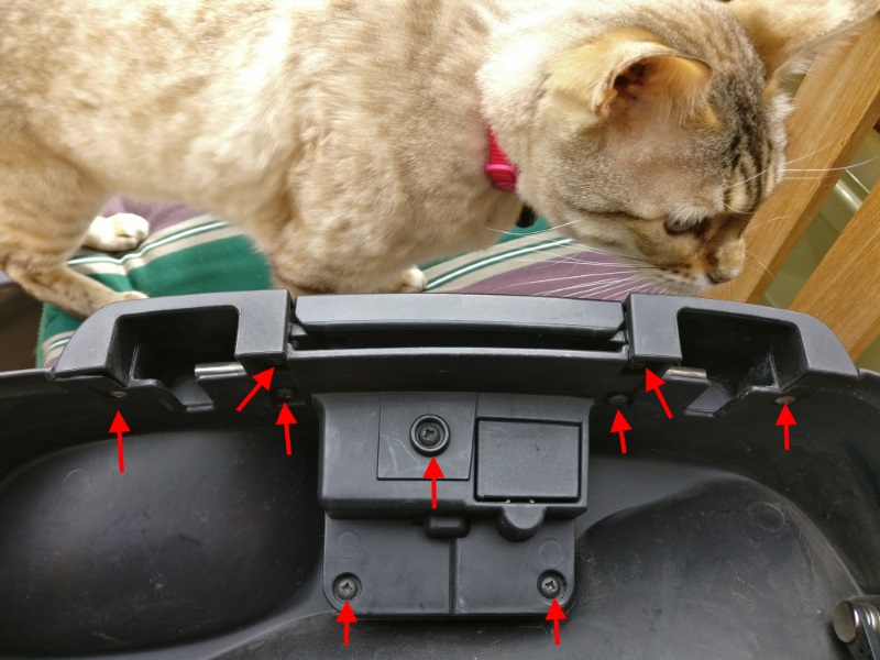

Screws to remove the lock+lever sub-unit:

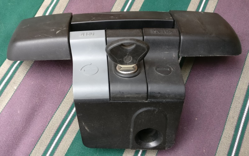

Got the lock+lever sub-unit off the pannier:
And what the bits are:

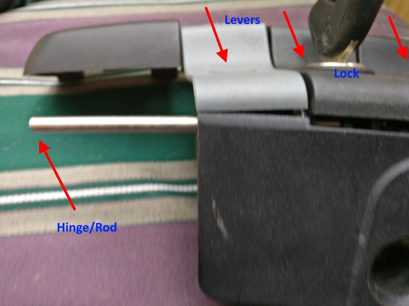

Only thing I could see was what turned out to be a hinge/rod running from one side of the complete mechanism to the other, for all the levers/handles to pivot on:

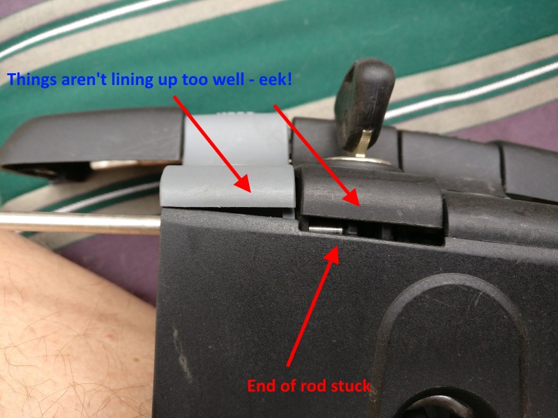

Knocked the hinge/rod out with a thin screwdriver, and then stuff started moving. Hmm, there's stuff going on in there that I can't see, so how on earth am I going to be able to put it back together if I go any further. Time to chicken out. So I put the hinge/rod back in:
and
Not so easy, the handles no longer lined up, but eventually after fiddling, I managed to slide the hingle/rod back in.
And that's how it's staying for the time-being.  :-[ :-[ :-[

« Reply #14 on: May 11, 2018, 03:57:04 pm »
The end lever furthest from the key is spring loaded and holds the barrel in place. If I remember you have to get at this lever and push against it and the barrel comes out complete with the key.
It helps if you can work out roughly where the end of the barrel would be (the barrel is about 25mm long), and the lever has to be depressed with a thin screwdriver inserted on the same plane as the key. If you can work out what I'm saying there is only one direction from which the screwdriver could be inserted.
If I remember correctly most of the handle assembly has to be dismantled.
