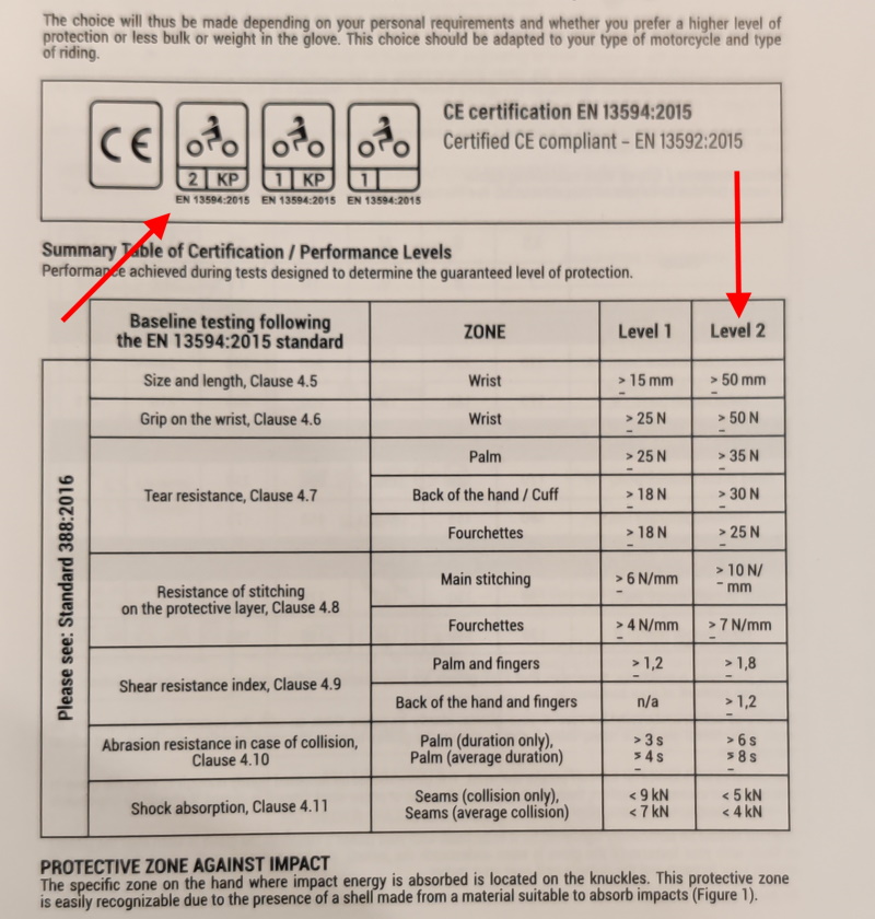

You're looking for something like the small bike logo + 2 + KP (the one the red arrow points to):

Although CE level 2 certification doesn’t require scaphoid protection, the table highlights enough reasons (e.g. seam burst strength) for me to prefer Level 2 gloves. Level 1 certification doesn’t mandate any shear resistance on the back of the hand and fingers!!
